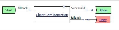

We are doing cert auth here is the APM policy
We are getting denies all the time I have uploaded the CA cert.

I made it a very simple APM policy

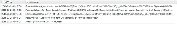

And changed the SSL CLIENT policy to request cert and through the browser I got the following successful message
When I test the exact same configuration with the edge client
I changed to ODCA browser looks good
with client same result
What troubles me is that the receive info on the edge client is WIN which makes scratch my head.

Adjusted accordingly same result turned on the debug does looks like the OCDA agent is working on the edge client as I do not see any cert authentication in the debug logs.
The browser is working fine.
- Gianrico_D_Ang1Historic F5 AccountEnable apm log level to "informational" and look at the session variables content in /var/log/apm
