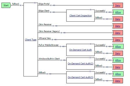

Need some help with repect to the APM.
We are doing cert auth here is the APM policy
We are getting denies all the time I have uploaded the CA cert.
When we use the...

Feb 25, 2015Adjusted accordingly same result turned on the debug does looks like the OCDA agent is working on the edge client as I do not see any cert authentication in the debug logs.
The browser is working fine.

Enable apm log level to "informational" and look at the session variables content in /var/log/apm
