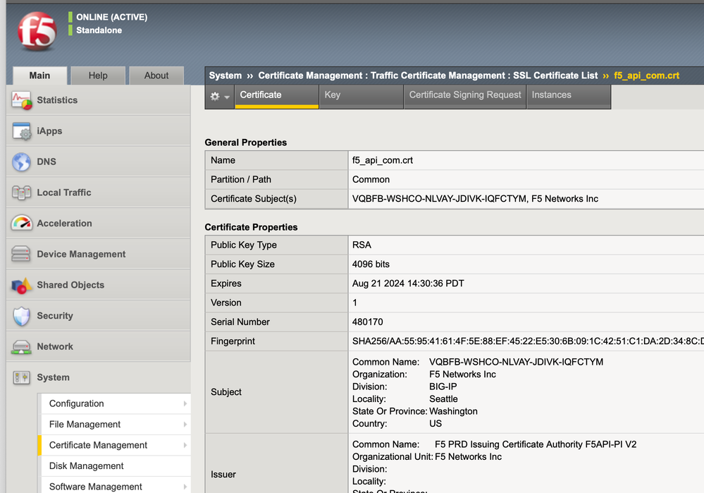

It looks like you may have imported the certificate into the trust store and not the issuer of the certificate into your trust store.
From the screenshot above it looks like The issuer may be different from the certificate. - srinidhi12

Assuming you are actually trying to access the api on the F5 you have provided screen shots for then the certificate you require is the device certificate not the certificate in traffic certificate management.
Install the device certificate from System ›› Certificate Management : Device Certificate Management : Device Certificate into your java Keystore to trust the self signed certificate used by the F5 device irtself.
