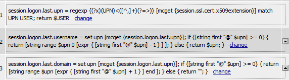

For the extraction of the upn from the certificate we use:
