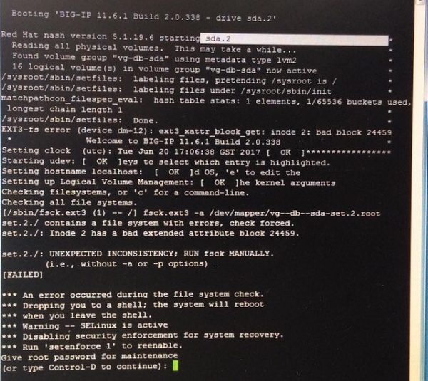

The following error occurred during the upgrade from 11.6.0 to 11.6.1 HF2. I am currently in Korea and the equipment is in the UAE. Is this a problem that can be solved remotely enough? Please help me.

Do exactly as the message says: Put in the root password and then run "fsck" (you will need to made some a decision what to do with each suggestion in the process). I hope you have a backup of everything.
