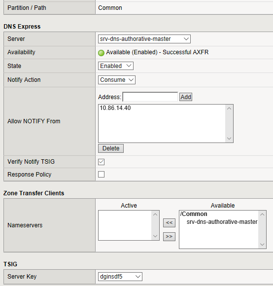

Hello guys, I'm setting up DNS Express to serve as a secondary NS for my zone. A hidden master is configured using NSD server. The initial AXFR query is successful when creating the zone on the BigIP. But when a notify is sent from the master to the BigIP, I'm getting an error (captured on tcpdump) saying : DNS123Zone change notification response 0xe24e Not authoritative SOA zone.com TSIG. NB: the IP address of the master is added on "Allow NOTIFY From" list Any hints

    • EA_Hicham's avatar
      EA_Hicham
      Hello Kevin, So, I erased all the DNS configuration and restarted from scratch following the K45411181 and adding the notification virtual server. Although, according to the article, it is not necessary to do so, since i'm not running an HA Cluster, it did solve the "Not authoritative SOA" problem. Unfortunately, it did not solve all my problems. NSD DNS Server does not implement IXFR responses. So unless forcing DNS Express to execute and AXFR each time, I don't think F5 DNS Express and NSD can work toghether (which is a bit strange). Cheers. Hicham
