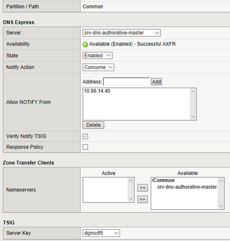

Greetings,
I set up UDP virtual server (notify listener) per this article and it seems to be working:K45411181: Configuring DNS Express using tmsh
https://support.f5.com/csp/article/K45411181When I change serial and initiate transfer from NS, DNS Express is updated. Without virtual, DNS Express says not authoritative.
Hope this is helpful!
Kevin
Greetings,
Kevin
- EA_HichamMar 18, 2018
Hello Kevin, So, I erased all the DNS configuration and restarted from scratch following the K45411181 and adding the notification virtual server. Although, according to the article, it is not necessary to do so, since i'm not running an HA Cluster, it did solve the "Not authoritative SOA" problem. Unfortunately, it did not solve all my problems. NSD DNS Server does not implement IXFR responses. So unless forcing DNS Express to execute and AXFR each time, I don't think F5 DNS Express and NSD can work toghether (which is a bit strange). Cheers. Hicham
