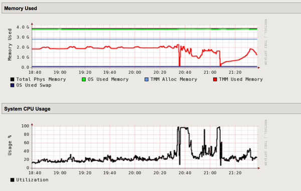

Hi my big ip system crash any time CPU reach 100% is there any way to debug this and find what cause the hight utilization? my system is using irules, HTTP Compression (with CPU Saver), stream profile, web acceleration it always happen when the connection & throughput is Hight
my system is 11.3

  • Hi Lior,
    Performance issues sometimes get very difficult to troubleshoot.
    ==> I see that you tmm memory utilization is quite high. ( Not sure if this is the baseline as per your environment.
    From my past experience i can suggest you to follow below process :
    1. Run the below command before the CPU spike and keep it running until you sees the spike. ctrl + c to stop the command
    while :; do date >> /var/tmp/top.out; top -cbn 1 >> /var/tmp/top.out; sleep 1; done
    1. From the above output file, check the process which is contributing to high CPU spikes.
    2. Check the output of below command :
    tmsh show /sys memory
    to see which process is taking up the highest memory
    ( Usually i prefer uploading the Qkview to ihealth and then checking the output of this command as it is easy to arrange with reference to size )
    1. Once you find the process, try to locate any specific bugs related to that process which could contribute to high cpu usage or memory usage.
    Hope this will help you nail down the issue.
  • JG's avatar
    JG
    Icon for Cumulonimbus rankCumulonimbus
    It seems that you are simply running out of memory: 4GB is the minimum of the amount of memory supported. There should be plenty of warning messages in your /var/log/ltm file at the time of the issue.
