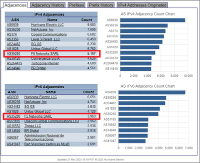

Let's start with an easy example. BGP peering relationships provide performance and resliency for networks in the case of outages of other global networks. If you review the Hurricane Electric Internet Services BGP Peering Report, you'll see F5 is one of the most peered global networks in the world with over 5000 IPv4 adjacencies and almost 4000 IPv6 adjacencies. This means our network is more easily reachable, with fewer hops, than almost any other network in the world.

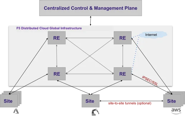

Secondly, as a SaaS provider, a big differentiator for F5 XC is the ability to deliver SaaS services within customers' premises by deploying nodes to create customer sites . These nodes connect to the two closest RE's to pull down their configuration, recieve updates, and connect to the globl backbone. Connections to these two RE's are made over two separate tunnelling protocols, TLS and IPSec, which means any CE running at your remote site has four redundant connections to the global backbone and control plane.
A simplified view of highly-meshed Regional Edges and redundancy for customer sites.

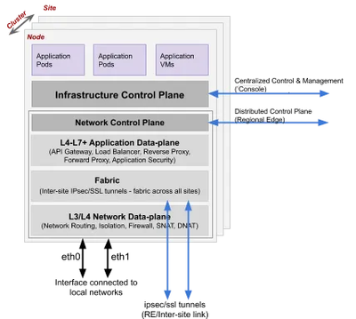

Thirdly, let's look at the services this platform provides (eg IP switching, firewalling, security services, running K8s workloads, etc). F5 XC is natively application-aware. The platform is run on our highly-meshed F5 XC global PoP's, each of which we call a Regional Edge (RE), and extended to customer sites as explained above.
This platform is made of many microservices to perform the various functions of the platform, and these microservices are managed at scale using K8s. So then, the F5 XC platform is a modern application in itself - it's fully distributed, updated frequently via automated releases, and broken up into many small parts, each of which can scale individually.
