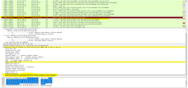

I have VIP setuo to handle http connections for one of my sites. but users report getting a err conn rest message on chrome and firefox.
i have replucated the issue on my machine and it seems you have to hit the url on the server 4-5 times and it chucks a conn reset to the user.
i performed a wireshark capture and got the below
BIG-IP: [0x23f168a:700] Flow expired (sweeper) (idle timeout)
when i see the tcp rst cause. log i get the following
Mar 23 10:58:57 lb1a-cpt err tmm[17861]: 01230140:3: RST sent from 10.0.91.96:80 to 196.43.208.62:55300, [0x23c0eba:9280] {peer} TCP retransmit timeout
I dnt know where lese to have a look as i have looked at the tcp profile and disabled tcp rst cause.log
and i am sill receiving a conn reset and this happens in less than a minute

  • my f5 sits behind the firewall there is a switch connected to the F5 and I have checked routes between the two and they know how to forward traffic to each other to the backend.
    I have attached the Wireshark output between my VIP and external client.
    as you can see the resets are random as the Wireshark shows the other connections to the vip and out are fine but there's one in red which shows the problem area. where the vip sends a reset to the external client.
    this is all basic config i setup a few of these all the same and they work fine except of this particular one i have also attached a screenshot of my VIP config

      Hi Lutha, thanks for your fast reply. I already had an support ticket for this case. We couldnt find a solution yet. I updated the severity at the highest now, because Exchange iApp is running so, sooo bad in our environment. I tried everything, googled everything. No solutions yet. There are alot of customers who are not able to work the last days. At first everything was running fine, but now we have such a poor perfomance, that 2010 clients can't even login OWA. Always "ERROR_CONNECTION_RESET".
      We checked everything, it is just the external services from exchange. If I access internal URL, everything is fast and stuff. I dont know what has happened.
