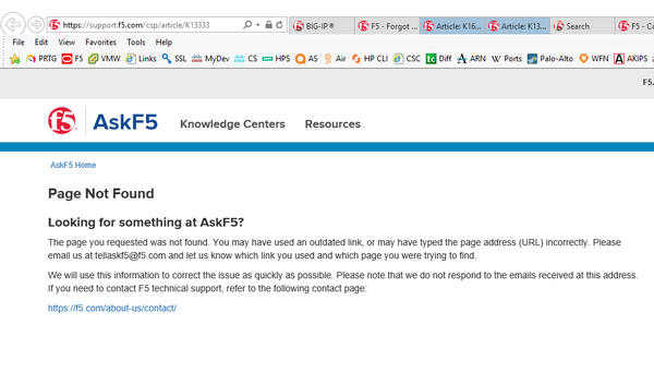

      I did see the article I'm sorry. I was able to access vi through edit option like the article displays but I'm unsure if erasing all facilities except " aauth-priv-from notice" & "auth-priv-to emerg" then saving will cause only logins to be sent to the syslog server. Could you please advise?
