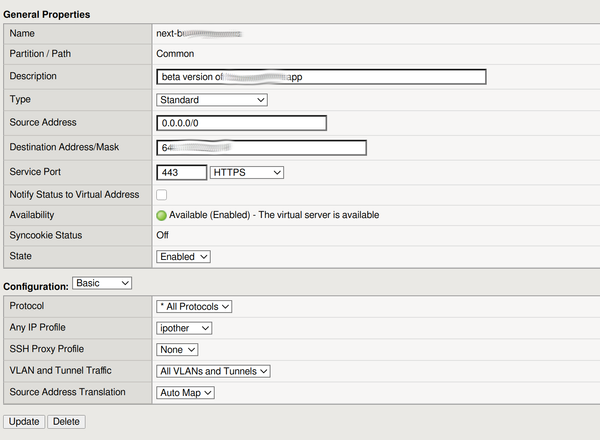

Hi,
Trying to open port 443 (https) without offloading ssl cert. If I dont setup any profile the BigIP does not forward traffic to my server. If I setup only server side SSL profile without any certificate, it forwards, but there is not information about requested host.
I cannot find any information how to do it properly.
Thank you for help
Luke

  • Hi Mayur,
    I tried that options, and it still does not work. I tried the simplest option which was
    the pool for that virtual server has one member 192.168.1.199 with the Service Port set to 0 (I selected *)
    I also tried exactly what you said, which was not http profile, no ssl profile for client and server and selected SNAT
    Any ideas? How to debug this stuff?

  • Thank you Mayur for help. I finally fixed it by  enabling Address Translation and Port Translation and setting Source Address Translation to AutoMap. Just two checkboxes fixed all issues. Now my Caddyserver v2 aoutoconfigure ssl and runs website without problems. Love it.
