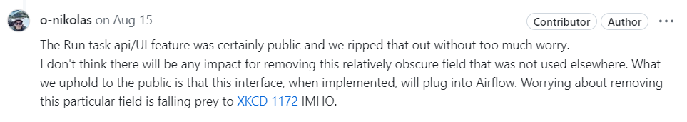

To address this security issue, the Apache Airflow project decided to disable this feature, stating that its release was a mistake.
You can refer to the commit below to learn more or see Figure 1 for additional details.
https://github.com/apache/airflow/pull/33397/commits/1410465e926b9bedb3f1ff9661a1910203cd6da8
 Figure 1: Disabling the "Run Task" feature

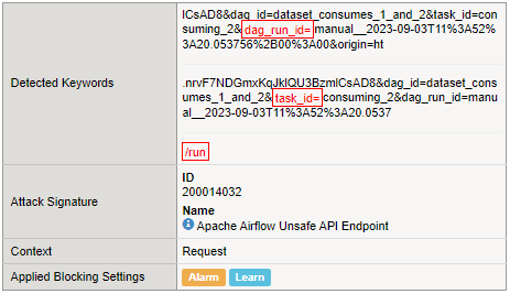

Mitigation with F5 BIG-IP Advanced WAF
BIG-IP Advanced WAF customers are already protected against the vulnerability, while the attack will be detected and blocked by the existing "Apache Airflow Unsafe API Endpoint" signature see Figure 2
 Figure 2 - CVE-2023-39508 attack vector blocked with Attack Signature (200014032)
So while it’s good to be aware of this vulnerability, BIG-IP Advanced WAF customers don’t need to do anything to mitigate this.
