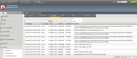

Good day, I have this problem, but my BIGIP version 15.1.3
There is an unfinished full sync already being sent for device group /Common/device-group-failover on connection 0x615856c8, delaying new sync until current one finishes.
