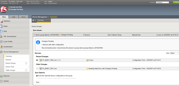

Configsync issue BIG-IP v13.1.4 (Build 0.0.3)
I am running 2 VE Bigip LTM as my lab, and having configsync issue. Both the devices are able to reach other, and all processes are running.
NTP is configured, configsync is via HA vlan.

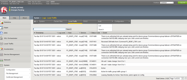

Receiving the below logs from the active box
There is an unfinished full sync already being sent for device group /Common/device-group-failover-c2f1f3ef7929 on connection 0x61f206c8, delaying new sync until current one finishes.

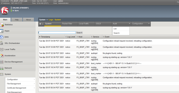

      I had the same issue with v16 and v15. I have tried every possibily troubleshooting out there on the F5 Kb. Finally running on v12 now.
      Doesnt look like config issue to me, because on v12 it works fine.
      The communication between the HA pairs are good but somehow it just doesnt sync. :(

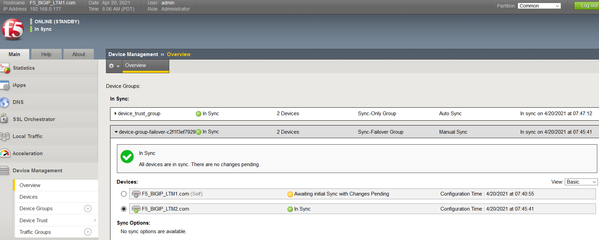

        1.Have your tried to monitor the config sync with "tmsh run /cm watch-devicegroup-device" (https://support.f5.com/csp/article/K13946) to see if you have the latest commit id?
