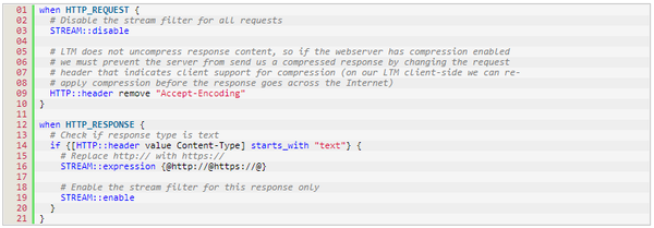

I create an irule with stream and after it, this just resolve one of them and the new answer is like this:
https:test1.test.pru
https:test2.test.pru
http:test3.test.pru
I tried to modify the irule but wasn't possible to correct the last behavior
Here the iRule:
What can i do to correct the last one?

  • Have you tried using Rewrite Redirects in the http profile? This will rewrite redirects to https for you.
  • So you have to work out exactly what you want to change here - the HTML code or the redirects sent from the server. If you want to change the HTML code then use the stream profile, if you want to rewrite redirects then use the Rewrite Redirects in the HTTP profile.
    As Michael says, you need to apply the default Stream profile to the VS and use the iRule to change the HTML code.
