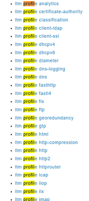

there are lots of profiles that can be configured.
