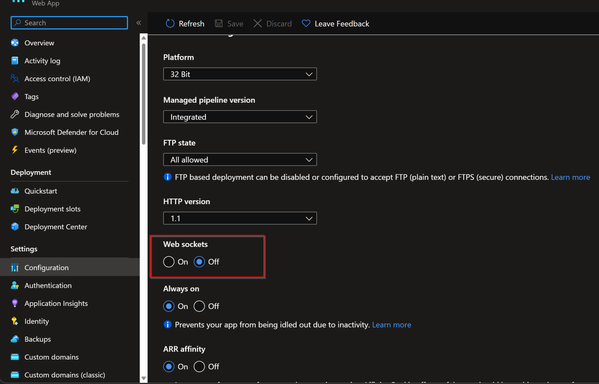

    There is definitely seems a load-balancer configuration issue. Can you confirm that you have configured the site as specified in the SignalR docs? Specifically, that "ARR Affinity" and "WebSockets" are both enabled as shown in the below screenshot.
    Based on the error message, I would suggest to check that Web Sockets weren't disabled for your app service.
    It's in General Settings under the Configuration blade.
    If it's enabled, then check for any firewall rules or NSGs that may have inadvertently applied to your app service.
