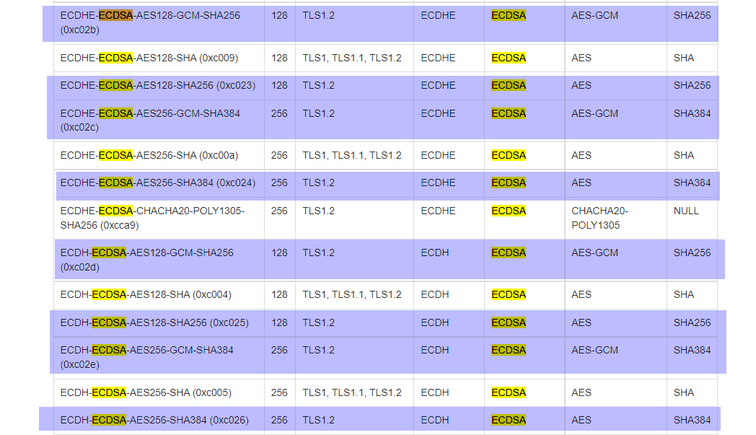

      • Hi SolarJeans ,
        For 15.1.x OS version following ciphers will get impacted , see the last column for 256 or 384
        when you will disable
        disable-algorithms "." {
                "ECDSAP256SHA256";
                "ECDSAP384SHA384";
        If any of the keys using these CIPHERS will cause error till the key validation time not expired based on ttl.
        https://support.f5.com/csp/article/K86554600
        ECDHE-ECDSA-AES128-GCM-SHA256 (0xc02b)128TLS1.2ECDHEECDSAAES-GCMSHA256
        ECDHE-ECDSA-AES128-SHA (0xc009)128TLS1, TLS1.1, TLS1.2ECDHEECDSAAESSHA
        ECDHE-ECDSA-AES128-SHA256 (0xc023)128TLS1.2ECDHEECDSAAESSHA256
        ECDHE-ECDSA-AES256-GCM-SHA384 (0xc02c)256TLS1.2ECDHEECDSAAES-GCMSHA384
        ECDHE-ECDSA-AES256-SHA (0xc00a)256TLS1, TLS1.1, TLS1.2ECDHEECDSAAESSHA
        ECDHE-ECDSA-AES256-SHA384 (0xc024)256TLS1.2ECDHEECDSAAESSHA384
        ECDHE-ECDSA-CHACHA20-POLY1305-SHA256 (0xcca9)256TLS1.2ECDHEECDSACHACHA20-POLY1305NULL
        ECDH-ECDSA-AES128-GCM-SHA256 (0xc02d)128TLS1.2ECDHECDSAAES-GCMSHA256
        ECDH-ECDSA-AES128-SHA (0xc004)128TLS1, TLS1.1, TLS1.2ECDHECDSAAESSHA
        ECDH-ECDSA-AES128-SHA256 (0xc025)128TLS1.2ECDHECDSAAESSHA256
        ECDH-ECDSA-AES256-GCM-SHA384 (0xc02e)256TLS1.2ECDHECDSAAES-GCMSHA384
        ECDH-ECDSA-AES256-SHA (0xc005)256TLS1, TLS1.1, TLS1.2ECDHECDSAAESSHA
        ECDH-ECDSA-AES256-SHA384 (0xc026)256TLS1.2ECDHECDSAAESSHA384
