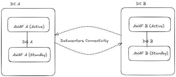

Any one tried to sync ASM configuration between 2 data centers successfully? my current scenario is, i have HA pair (active/passive) in data center A and another HA pair (active/passive) in data center B and need to sync the the ASM configuration between the 2 data centers.

    Assume we have ( Device 1,2 in DC_A  & Devices 3,4 in DC_B )

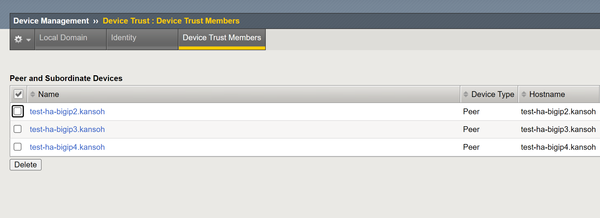

      1. open BIGIP 1 >>> ( add Devices ( 2,3,4) in the Trust like this:

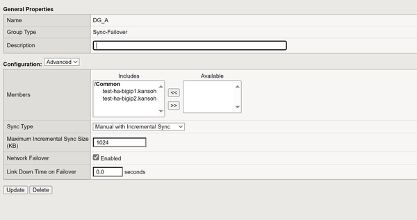

        1. Configure a Device Group ( SYNC-Failover ) type , Manual sync with incremental.
        2. Move just only Devices (1,2) from available box to includes box like this:

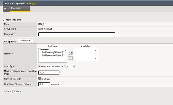

      2. In Device 3 " which is in DC_B"
        2. Move just only Devices (3,4) from available box to includes box like this:
        3.

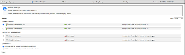

      4. Go to overview (Device management >> Overview ) tab and make the initial sync manually.
      5. After That, Return back to Device groups TAB and then open the ASM Device group policy , and change it from manually to automatic Sync with incremental if you want that, you can leave it manual if you require to do the manual sync with each change in ASM policies, so the ASM Device group will be like this:
        3.

      1. first when i reset the device Trust for all devices , all devices become active standalone.

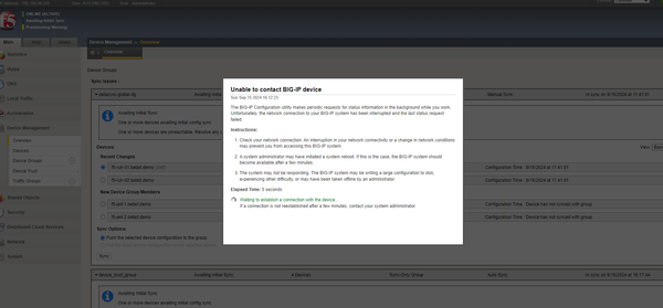

      2. i added devices 2,3 and 4 to the first device, but still i see it as not trusted with first device, it showing as disconnected (specially for 3 and 4), i tried to sync between the devices but still not connected . Also, when trying to access Device Management  â€ºâ€º  Overview, it takes sometime to open and after sometime it is disconnect and i have to refresh the page to connect again. Kindly check the snapshot:

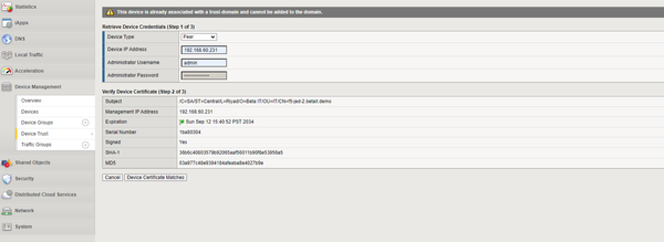

      4. i tried to add device 4 to device 3 to do the HA, it gives an error that this device already associated with a trust domain
