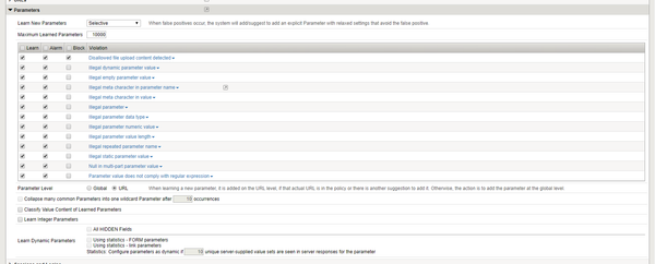

Hi
I am testing this out for a scenario where learning is not happening.
I am using the lab auction site now :
The description parameter is not added to the parameters list and wildcard is set to staging, and yet asm does not learn anything for this parameter.
The learning mode is selective.

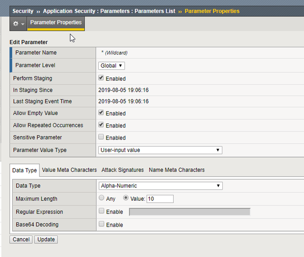

    As there is a wildcard parameter you won't get this violation, as there is a wildcard parameter. Instead, if you click on Accept Request then it will add the Description parameter and then amend the parameter length on this newly added parameter. At least that is what I would expect.

    I don't think you will. It'll only get added as part of the Selective configuration on the wildcard in order to allow a greater URL length. Learning is only for violations and there is no illegal parameter violation, only a length violation.

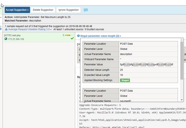

      Yes I was not getting even that.
      Now i checked the length on the wildcard and it was any, so i made it 10 and now it works fine.
      It needs the description parameter to be diff from the WC, so its alright now i guess.
