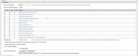

Hi I am testing this out for a scenario where learning is not happening. I am using the lab auction site now : The description parameter is not added to the parameters list and wildcar...

I think you're saying that you don't see an Illegal Parameter violation so cannot learn, hence add, this parameter to the policy in the Learning Suggestions? Pls advise if I have misunderstood this.
As there is a wildcard parameter you won't get this violation, as there is a wildcard parameter. Instead, if you click on Accept Request then it will add the Description parameter and then amend the parameter length on this newly added parameter. At least that is what I would expect.

Aug 05, 2019I think I did mix it up
What I meant was I could not see any recommendations for the parameter in traffic learning.
Which I think should be there since the mode chosen is selective and the attributes of description parameter are different from the wildcard.
So that's what I'm expecting..!
