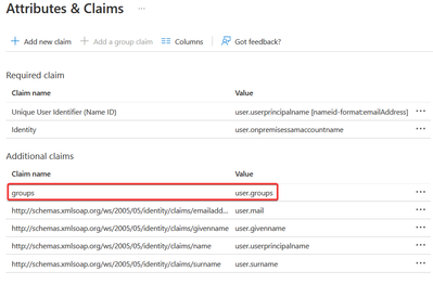

AAD Groups - not exactly synced, rather a list returned in the SAML response as an additional claim we've configured within the F5 AAD app - see image below.
