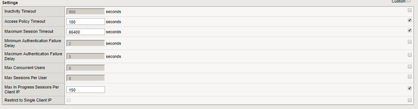

      This is my setup on policy:

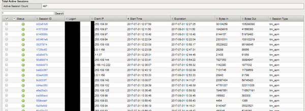

      I have a pair Active/Active that process internal and external traffic to this vdi policy. I can realize that issue only occurs on internal traffic box, specially to zabbix monitor ip address.
      External traffic (OK)
      Internal traffic (NOK). It have policies living more than a day. I run a own script to clean the older ones occasionally. I have thinking to schedule this as daily job, if it don't have a solution.

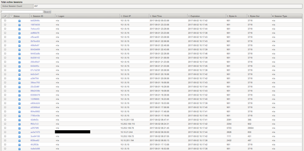

      Here the "not_started" policies:
      Any suggestion? What is wrong here?
