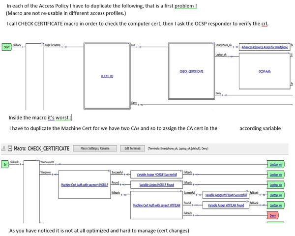

  • Salut à tous,
    Stanislas gave me a first tip but my problem is more complex, let me explain more : - I have to check computer certs in multiple access profiles - In each of them I must check that the cert issuer is from CA1 or CA2 ... - I also have to save the CA cert issuer for the OCSP check ... As you may see in the attached screenshot it's getting not easy to manage and really bad optimization.
    Bonne journèe
