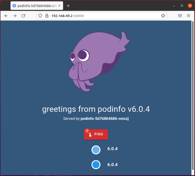

I could not get this working. However, what worked out for me was the following:
daniel@ubuntu:~$ minikube service --all
😿 service default/kubernetes has no node port
| NAMESPACE | NAME | TARGET PORT | URL |
| default | kubernetes | No node port |
| default | podinfo | 80 | http://192.168.49.2:30009 |
And then I could open the app in the browser with the URL displayed here in this chart.
