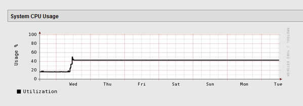

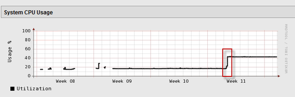

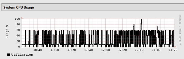

After upgrade to 11.6 HF4 on a BIG-IP 2000s cluster (from 11.4.1 HF4) average cpu consumption is much more higher (active and standby unit!). After some investigation I found out that the "mysqld" process consumes up to 100% of one cpu-core in 5min intervals, only for 3-5 secs. On a heavy loaded system this could have serious performance impacts of course. See graphs below:
CPU 30 days graph:
CPU 7 days graph
CPU 3 hours graph
Actually all services are running stable with 11.6 HF4 far, but of course CPU usage statistics are approx. 20% higher with 11.6 HF4 than before upgrade!

Just tried with "bigstart stop asm" but still the same high CPU issue. I also de-provisioned the ASM module, rebooted the VM and still the same issue with LTM/APM.
In the meantime I disabled AVR again and did a reboot of both cluster members. Right now it seems that the high CPU peaks are still there but only around 40-60% and much shorter then before.
Anyway I will monitor the CPU usage in the next few hours to see if AVR caused the high CPU usage. Keep you posted.

12 hours later CPU usage is still around 40% average on both cluster members! Enabled modules LTM/APM. I opened a ticket at f5 support but no response so far...

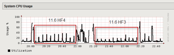

Hi all,
I just downgraded my lab vm to 11.6 HF3 and as you can see in the graph below, cpu usage peaks went down to the half:
So for me it's obvious that f5 changed something in the AVR code from HF3 to HF4.
In the meantime I got an answer from f5 support that this kind of mysql high cpu usage should be the normal behaviour beginning with 11.6, doesn't matter if AVR is enabled or not...;-)
I will try to reset the customers AVR statistics database by tomorrow morning according to SOL14956, maybe this will help...
