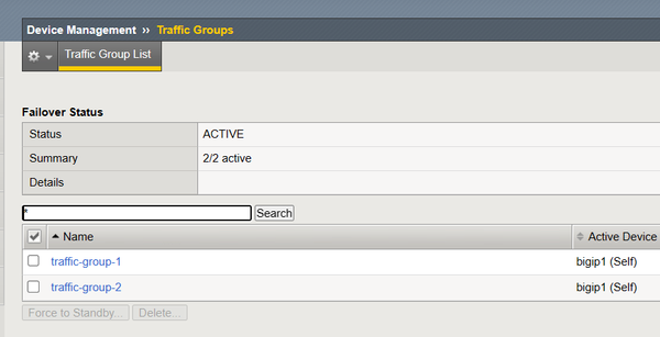

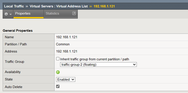

  • You can use solution traffic group for control virtual server active on both F5 Device
    - Create traffic group and setup active traffic group active on different device
    Apply traffic group to virtual address.
