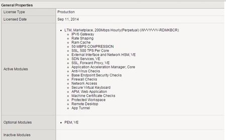

Where can I see the license information for my F5 products?
You are looking at the correct screen. The license should be valid as long as the AWS subscription is valid.
