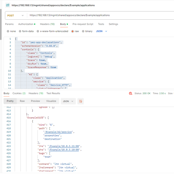

Then we will change for example virtual server ip from 10.0.3.10 to 10.0.3.11 and we will send the same declaration but with "dryRun" set to true as this will cause AS3 to validate the config but not to execute it and with trace and traceResponse we will get the difference 😎

Now we see that the IP has been changed from 10.0.3.10 to 10.0.3.11 and here we go now we have the difference !
This can be added in CI/CD to always first do "dry-run" using the original declaration to see if there are changes before executing the new AS3 declaration that could be for example changing the IP address to 10.0.3.12 but using the official way. Look at the Json reply "diff" section that is seen thanks to trace and traceResponse options and an automation can just check this section and stop the new deployment if the manual changes need to be reviewed first.
