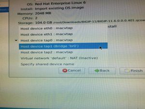

Hello, I have been trying to setup an F5 lab using KVM on debian. I currently have the following network configuration (/etc/network/interfaces - see output pasted at end of post) although whenever I go to create the VM in KVM, only one tap is associated with the bridge (trying to use the taps for management, external, and internal interfaces on the F5 VM). (see screenshot at end of post) Would anyone have any suggestions for configuring networking properly for this setup? I'm open to anything at this point in time. Thanks for your help. source /etc/network/interfaces.d/* auto lo iface lo inet loopback allow-hotplug eth0 iface eth0 inet dhcp iface eth0 inet6 auto auto br0 iface br0 inet dhcp pre-up ip tuntap add dev tap0 mode tap user root pre-up ip tuntap add dev tap1 mode tap user root pre-up ip tuntap add dev tap2 mode tap user root pre-up ip link set tap0 up pre-up ip link set tap1 up pre-up ip link set tap2 up bridge_ports all tap0 tap1 tap2 bridge_stp off bridge_maxwait 0 bridge_fd 0 post-down ip link set tap0 down post-down ip link set tap1 down post-down ip link set tap2 down post-down ip tuntap del dev tap0 mode tap post-down ip tuntap del dev tap1 mode tap post-down ip tuntap del dev tap2 mode tap382Views0likes1CommentCreated new vcmp guest with initial image 11.5.1, but sys software shows version 11.4.1
