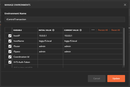

Problem this snippet solves: This is an example set for iControlREST which generates an Authentication Token and a Transaction session to add a new Data Group. This is only a single change but you can add many changes into the Transaction before VALIDATING and committing them. Steps taken: Get Auth Token - Request to generate a new Authentication Token and saves into the Environment variable X-F5-Auth-Token Extend Token Timeout - Increases the timeout value of the Auth Token, not always needed but good if you are running the command manually Get New Transaction - Request to generate a new Transaction session and saves into the Environment variable Coordination-Id POST new DG in Transaction - Creates a new Data Group Get Transaction Commands - Optional request to list all the commands and the order in the transaction Commit Transaction - Sends VALIDATING request to validate and commit the commends Get DG test - Optional to get the Data Group to confirm it has been created Find more information about iControlREST Transactions here https://devcentral.f5.com/s/articles/demystifying-icontrol-rest-part-7-understanding-transactions-21404 and in the user guides https://clouddocs.f5.com/api/icontrol-rest/ How to use this snippet: Download and install Postman https://www.getpostman.com/downloads/ Save the below JSON to a file and import as a new Postman Collection (see https://learning.getpostman.com/docs/postman/collections/intro_to_collections/ and https://learning.getpostman.com/docs/postman/collections/data_formats/#importing-postman-data). Finally setup a new Environment (https://learning.getpostman.com/docs/postman/environments_and_globals/manage_environments/) within Postman and ensure you have the following elements: hostIP - the Management IP of the F5 BIG-IP system hostName - the Hostname of the F5 BIG-IP system f5user - the username used to generate an Authentication Token f5pass - the password used to generate an Authentication Token X-F5-Auth-Token - leave blank will auto populate Coordination-Id - leave blank will auto populate e.g. Then you can run the Postman collection one request at a time or run via Postman's Collection Runner (https://learning.getpostman.com/docs/postman/collection_runs/using_environments_in_collection_runs). Code : { "info": { "_postman_id": "67195ea2-5ac0-4599-a650-5951b1bc1184", "name": "iControl Transaction Example", "schema": "https://schema.getpostman.com/json/collection/v2.1.0/collection.json" }, "item": [ { "name": "Get Auth Token", "event": [ { "listen": "test", "script": { "id": "6e3f6680-4199-4c4a-a210-272b4d2eef38", "exec": [ "tests[\"Status code is 200\"] = responseCode.code === 200;", "var jsonData = JSON.parse(responseBody);", "postman.setEnvironmentVariable(\"X-F5-Auth-Token\", jsonData.token.name);", "", "" ], "type": "text/javascript" } } ], "request": { "method": "POST", "header": [ { "key": "Host", "type": "text", "value": "{{hostName}}" }, { "key": "Content-Type", "value": "application/json" } ], "body": { "mode": "raw", "raw": "{\r\n\t\"username\":\"{{f5user}}\",\r\n\t\"password\":\"{{f5pass}}\",\r\n\t\"loginProviderName\": \"tmos\"\r\n}" }, "url": { "raw": "https://{{hostIP}}/mgmt/shared/authn/login", "protocol": "https", "host": [ "{{hostIP}}" ], "path": [ "mgmt", "shared", "authn", "login" ] } }, "response": [] }, { "name": "Extend Token Timeout Copy", "event": [ { "listen": "test", "script": { "id": "3bcdcdc6-fcad-46db-b9c0-4d7a8e8e1a69", "exec": [ "var jsonData = JSON.parse(responseBody);", "tests[\"Status code is 200\"] = responseCode.code === 200;", "tests[\"Token has been set\"] = jsonData.timeout == 36000;", "tests[\"Token is valid\"] = jsonData.userName === postman.getEnvironmentVariable(\"f5user\");", "" ], "type": "text/javascript" } } ], "request": { "method": "PATCH", "header": [ { "key": "Host", "value": "{{hostName}}", "type": "text" }, { "key": "Content-Type", "value": "application/json" }, { "key": "X-F5-Auth-Token", "value": "{{X-F5-Auth-Token}}" } ], "body": { "mode": "raw", "raw": "{\n\t\"timeout\":\"36000\"\n}" }, "url": { "raw": "https://{{hostIP}}/mgmt/shared/authz/tokens/{{X-F5-Auth-Token}}", "protocol": "https", "host": [ "{{hostIP}}" ], "path": [ "mgmt", "shared", "authz", "tokens", "{{X-F5-Auth-Token}}" ] } }, "response": [] }, { "name": "Get New Transaction", "event": [ { "listen": "test", "script": { "id": "cb847d93-2c3a-4990-8242-020d95532be6", "exec": [ "var jsonRsponse = JSON.parse(responseBody)", "pm.environment.set(\"Coordination-Id\", jsonRsponse.transId);", "", "" ], "type": "text/javascript" } } ], "request": { "auth": { "type": "noauth" }, "method": "POST", "header": [ { "key": "Host", "value": "{{hostName}}", "type": "text" }, { "key": "content-type", "value": "application/json", "type": "text" }, { "key": "X-F5-Auth-Token", "value": "{{X-F5-Auth-Token}}", "type": "text" } ], "body": { "mode": "raw", "raw": "{}" }, "url": { "raw": "https://{{hostIP}}/mgmt/tm/transaction/", "protocol": "https", "host": [ "{{hostIP}}" ], "path": [ "mgmt", "tm", "transaction", "" ] } }, "response": [] }, { "name": "POST new DG in Transaction", "request": { "auth": { "type": "noauth" }, "method": "POST", "header": [ { "key": "Host", "value": "{{hostName}}", "type": "text" }, { "key": "content-type", "value": "application/json", "type": "text" }, { "key": "X-F5-Auth-Token", "value": "{{X-F5-Auth-Token}}", "type": "text" }, { "key": "X-F5-REST-Coordination-Id", "value": "{{Coordination-Id}}", "type": "text" } ], "body": { "mode": "raw", "raw": "{\n \"partition\": \"Common\",\n \"name\": \"url_filter_dg\",\n \"records\": [\n {\n \"name\": \"/data\",\n \"data\": \"Allow\"\n },\n {\n \"name\": \"/filter\",\n \"data\": \"Block\"\n },\n {\n \"name\": \"/hello\",\n \"data\": \"Black\"\n },\n {\n \"name\": \"/login\",\n \"data\": \"Allow\"\n }\n ],\n \"type\":\"string\"\n}" }, "url": { "raw": "https://{{hostIP}}/mgmt/tm/ltm/data-group/internal", "protocol": "https", "host": [ "{{hostIP}}" ], "path": [ "mgmt", "tm", "ltm", "data-group", "internal" ] } }, "response": [] }, { "name": "PUT DG in Transaction", "request": { "auth": { "type": "basic", "basic": [ { "key": "password", "value": "admin", "type": "string" }, { "key": "username", "value": "admin", "type": "string" } ] }, "method": "PUT", "header": [ { "key": "Host", "value": "{{hostName}}", "type": "text" }, { "key": "content-type", "value": "application/json", "type": "text" }, { "key": "X-F5-REST-Coordination-Id", "value": "{{Coordination-Id}}", "type": "text" } ], "body": { "mode": "raw", "raw": "{\n \"records\": [\n {\n \"name\": \"/data\",\n \"data\": \"Allow\"\n },\n {\n \"name\": \"/filter\",\n \"data\": \"Block\"\n },\n {\n \"name\": \"/hello\",\n \"data\": \"Allow\"\n },\n {\n \"name\": \"/login\",\n \"data\": \"Allow\"\n }\n ]\n}" }, "url": { "raw": "https://{{hostIP}}/mgmt/tm/ltm/data-group/internal/~common~url_filter_dg", "protocol": "https", "host": [ "{{hostIP}}" ], "path": [ "mgmt", "tm", "ltm", "data-group", "internal", "~common~url_filter_dg" ] } }, "response": [] }, { "name": "Get Transaction Commands", "event": [ { "listen": "test", "script": { "id": "cb847d93-2c3a-4990-8242-020d95532be6", "exec": [ "", "", "" ], "type": "text/javascript" } } ], "protocolProfileBehavior": { "disableBodyPruning": true }, "request": { "auth": { "type": "noauth" }, "method": "GET", "header": [ { "key": "Host", "value": "{{hostName}}", "type": "text" }, { "key": "content-type", "value": "application/json", "type": "text" }, { "key": "X-F5-Auth-Token", "value": "{{X-F5-Auth-Token}}", "type": "text" } ], "body": { "mode": "raw", "raw": "{}" }, "url": { "raw": "https://{{hostIP}}/mgmt/tm/transaction/{{Coordination-Id}}/commands", "protocol": "https", "host": [ "{{hostIP}}" ], "path": [ "mgmt", "tm", "transaction", "{{Coordination-Id}}", "commands" ] } }, "response": [] }, { "name": "Commit Transaction", "event": [ { "listen": "test", "script": { "id": "8308b285-b26b-4ddf-8ea9-e4f420cccd42", "exec": [ "var jsonResponse = JSON.parse(responseBody)", "", "pm.test(\"Transaction status is COMPLETED\", function () {", "", " pm.expect(jsonResponse.state == \"COMPLETED\");", "});" ], "type": "text/javascript" } } ], "request": { "auth": { "type": "noauth" }, "method": "PATCH", "header": [ { "key": "Host", "value": "{{hostName}}", "type": "text" }, { "key": "content-type", "value": "application/json", "type": "text" }, { "key": "X-F5-Auth-Token", "value": "{{X-F5-Auth-Token}}", "type": "text" }, { "key": "X-F5-REST-Coordination-Id", "value": "1557741207510527", "type": "text", "disabled": true } ], "body": { "mode": "raw", "raw": "{ \"state\":\"VALIDATING\" }" }, "url": { "raw": "https://{{hostIP}}/mgmt/tm/transaction/{{Coordination-Id}}", "protocol": "https", "host": [ "{{hostIP}}" ], "path": [ "mgmt", "tm", "transaction", "{{Coordination-Id}}" ] } }, "response": [] }, { "name": "Get DG test", "request": { "auth": { "type": "noauth" }, "method": "GET", "header": [ { "key": "Host", "value": "{{hostName}}", "type": "text" }, { "key": "X-F5-Auth-Token", "value": "{{X-F5-Auth-Token}}", "type": "text" } ], "body": { "mode": "raw", "raw": "" }, "url": { "raw": "https://{{hostIP}}/mgmt/tm/ltm/data-group/internal/~common~url_filter_dg", "protocol": "https", "host": [ "{{hostIP}}" ], "path": [ "mgmt", "tm", "ltm", "data-group", "internal", "~common~url_filter_dg" ] } }, "response": [] } ] } Tested this on version: No Version Found1.3KViews2likes0CommentsUpgrade BigIP using Ansible
