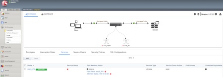

Hi Everyone, I am very new in f5 and I am trying to implement an SSLO I was able to configure and deploy it but I am having trouble getting it connected to my security service I indicated (Generic Layer3 inline). I am unable to Ping both sides even if they are in the same network/subnet. Please see the screenshot for reference . by the way this is just a Lab environment I just really want to know how to implement it.444Views1like1CommentCan SSL Orchestrator do daisy chaining to a Proxy first then to an ICAP server?

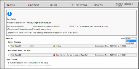

hi, i have a problem trying to sync a cluster f5 ssl orchestrator. It turns out that the configuration is guided by the wizard, where you create the service chain and others, but I do it in the active one and then I cannot synchronize due to an error that it cannot find the VLAN, what should I do in that case?273Views0likes0Comments
