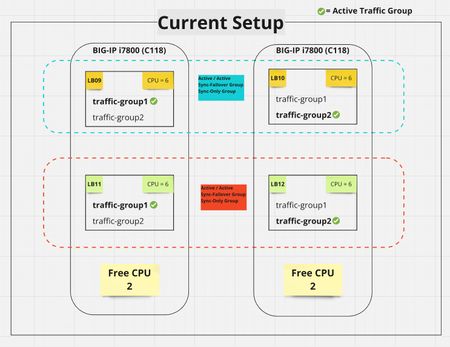

Hello, We have a pair of i7800 devices, each running two guests with the following configuration: i7800 Unit 1: LB09 & LB11 i7800 Unit 2: LB10 & LB12 Current Setup: LB09 & LB10: These are part of a High Availability (HA) pair, running in an Active/Active configuration. LB11 & LB12: Similarly, these two guests are also in an HA pair, running in Active/Active mode. Each LBx unit is utilizing 6 CPUs (which is the maximum allowed per guest). The i7800 comes with 14 CPUs total, so there are 2 unused CPUs per unit (not allocated to any guest). Questions: Can we bring up new BigIP units (LB13 & LB14) using the 2 free CPUs on each i7800 unit? Can these new units join the existing HA pair of LB11 & LB12 and sync configuration to each other? Can the new Units serve their own traffic groups ( as shown below in the diagram ) ? Is there any potential limitation or issue with utilizing the remaining CPUs for this purpose? Will i7800 run out of memory or go low in memory ? Goal: Offload 20% of the traffic (a handful of VIPs) to the newly created LB13 & LB14 units. All LBxx ( 11,12,13 & 14 ) should back each other up and sync configuration across Thank you for any assistanceSolved800Views0likes13CommentsFailover object missing in traffic group
