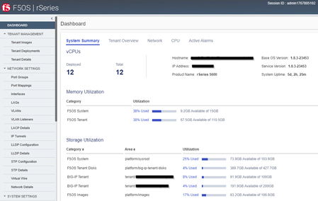

I'm currently configuring the required OIDs for monitoring our new rSeries, but I'm wondering if the provided MIBs contain all information? I'm searching especially the values from the GUIs dashboard for Memory Utilization and Storage Utilization like in the following screenshot: Also the mentioned "Base OS Version" and "Service Version" details seems to be not part of the MIB. I only found it under the OID .1.3.6.1.2.1.1.1.0 -> SNMPv2-MIB::sysDescr.0 = STRING: F5 rSeries-r5600 : Linux 3.10.0-1160.119.1.f5.1.el7_8.x86_64 : Appliance services version 1.8.3-23453. Where does the GUI render these information from? Is it possible to poll these details via SNMP as well? Any more details would be very helpful! Thank you! Regards, Stefan :)332Views0likes2CommentsF5OS login with admin/root failed via console
