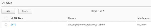

I must notice, that there seems to be a length restriction when creating VLANs on F5OS.

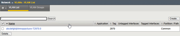

I'm allowed to enter long names on F5OS-level without any warnings or errors, but when assigning them to a tenant, the name within the tenant will be truncated if its longer than 31 characters.
It looks like this, means there is a suffix in the format of "-T<VLAN-ID>.0"
On F5OS-level it looks like this:
Is this a normal behavior? Can or will this be fixed?

    I have reviewed the VLAN naming behavior on your environment (F5OS 1.8.3 with BIG‑IP 17.5.1.3), and based on my findings i can  share that what you are observing is expected and normal system behavior.
    F5OS and BIG‑IP tenants follow different naming constraints:
    The BIG‑IP tenant layer (TMOS‑based) enforces a maximum VLAN name limit of 31 characters.
    When a VLAN is pushed from F5OS into a tenant, F5OS automatically:
    Truncates the VLAN name to meet the TMOS limit
    Appends a system‑generated suffix in the format:
    “-T<VLAN‑ID>.0”
    This ensures each VLAN name remains unique within the tenant environment.
    And this is not a defect or BUG,  this is functioning as designed.
    The naming restriction comes from TMOS, not F5OS, and the automatic truncation is the expected compatibility behavior.
    For reference, F5 documents these TMOS naming constraints here:
    Reference
    K16539386: VLAN name with more than 31 characters causes issues for F5OS BIG-IP tenants such as mcpd errors and config load failure
    https://my.f5.com/s/article/K16539386
    Recommended Actions
    Use VLAN names that are a maximum of 31 characters to avoid this issue.
    To recover from the problematic state:
    • Ensure VLANs are no longer than 31 chars in F5OS and tenant's bigip_base.conf
    • Any references to renamed VLANs should be updated in the bigip_base.conf as needed
    • Reload config via mcpd forceload (K13030)
    • Upgrade to a version with the fix for bug ID1183901
    HTH
    Best regards
    F5 Design Engineer
