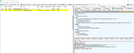

Hello all, I have a problem with the APM, I have an application published and sometimes the users are unable to see the login page, instead of that they get the logout page. This is very strange because it doesn't happens all the times, only sometimes so for me this seems a cookie problem or something like that. I've been using the fiddler tool and I've seen that sometimes when the my.policy URL is called the F5 closes the connection and redirect the user to /vdesk/hangup.php3, also in the same GET I see the session cookies and it seems to be ok. There is no iRules that redirects the request to /vdesk/hangup.php3 and I've not modified the logon page code. Do you know why could this be happening?6.2KViews0likes8CommentsKerberos Delegation and NTLM auth Exchange 2013
