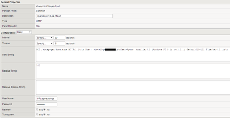

Hi Team, I have been working with my AD team trying to resolve a problem where they forget to update a Domain Controller certificate and it expires and ADLDAPS queries fail since they dont bind to expired certificates. They have requested to see if we can drop a member out of the pool if the certificate is expired ( ie, not a valid SSL cert ) I have been messing with the LDAP Health monitor, turning on the Security settings, but I dont believe this would actually check that a certificate is valid or not. I know with server side SSL configuration you can enable SSL authentication but would just stop traffic from flow, not actually drop a member out of the pool. Any ideas ?1.4KViews0likes4CommentsSharepoint 2010 Health Monitor
I have an HTTP GET health monitor setup for our Sharepoint 2010 servers. The health montior seems to work as I am seeing 200s come back from the server after authentication. However, what I'm also seeing is the health monitor sending along several GETs without the NTLM credentials and those come back with 401 authentication errors: Logs from Sharepoint server...top two are not successful as the LTM did not send along the credentials of PPL\spsearchqa. Bottom two are successful with the creds: 2015-04-24 13:48:04 xxx.xxx.xxx.xxx GET /sitepages/Home.aspx - 80 - xxx.xxx.xxx.xxx Mozilla/5.0+(Windows+NT+5.1;+rv:2.0.1)+Gecko/20100101+Firefox/4.0.1 401 2 5 5 2015-04-24 13:48:04 xxx.xxx.xxx.xxx GET /sitepages/Home.aspx - 80 - xxx.xxx.xxx.xxx Mozilla/5.0+(Windows+NT+5.1;+rv:2.0.1)+Gecko/20100101+Firefox/4.0.1 401 1 2148074254 5 2015-04-24 13:48:08 xxx.xxx.xxx.xxx GET /sitepages/Home.aspx - 80 PPL\spsearchqa xxx.xxx.xxx.xxx Mozilla/5.0+(Windows+NT+5.1;+rv:2.0.1)+Gecko/20100101+Firefox/4.0.1 200 0 64 12045 2015-04-24 13:48:14 xxx.xxx.xxx.xxx GET /sitepages/Home.aspx - 80 PPL\spsearchqa xxx.xxx.xxx.xxx Mozilla/5.0+(Windows+NT+5.1;+rv:2.0.1)+Gecko/20100101+Firefox/4.0.1 200 0 64 10075 Here is how my health monitor is setup: Any help would be very much appreciated. Thank you!499Views0likes3CommentsGTM Internal and External View configuration
