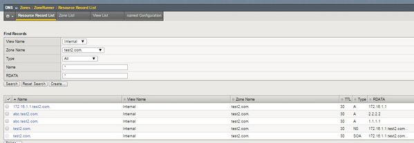

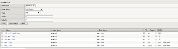

One of our customer requirement is to configure GTM as DNS server for both external user and internal user. Few of the records are common for both internal and external user but ip address are different. eg : abc.test2.com fqdn, 1.1.1.1 is ip address for external user and 2.2.2.2 is ip address for internal user.
This is first time we are doing such internal and external view configuration on GTM, so we tested this first on lab env. On over lab setup we created external view for test2.com with 172.16.1.1 as SOA and resource record for abc.test2.com (1.1.1.1) and created internal view for test2.com with 192.192.1.1 as SOA and resource record for abc.test2.com (2.2.2.2), we were able to create internal and external zone and resource record . But both View have both abc.test2.com (1.1.1.1) and abc.test2.com (2.2.2.2) record, also internal view SOA is overwritten with 172.16.1.1(external view IP).
Please help me how to configure internal and external view.
Below are screenshot taken from view and zone.
External view
Internal view
View list
Zone list
Thanks, Sachin

How do you have the Views configured? Specifically what is in the "options" field in the view configuration settings?
Seth
