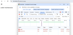

Hi, I would like to try the F5 Distributed Cloud simulation. When I access the simulator URL from the link "https://community.f5.com/kb/distributedclouduserstkb-board/f5-distributed-cloud-services-simulator/297996", I get an error. Does anyone know about this issue? Is it not available anymore? Thanks for any help/Guidance. Any input is much appreciated266Views0likes11CommentsF5 XC and Azure FrontDoor
