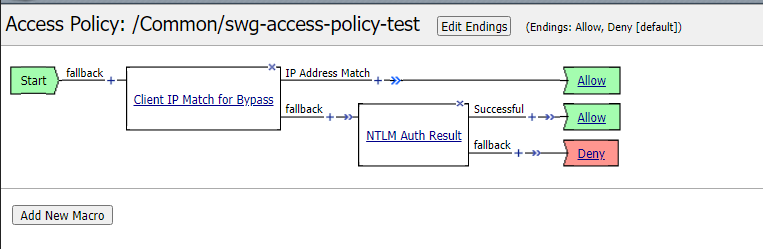

We want to be able to exclude a few clients (IP addresses) from the Authentication (Access-Policy). In the best of worlds we still want the url-checks from SWG but if this is not possible a total bypass could also be ok.
We have tried to make an exception in the Access-Policy (see the picture) where we specify the IP-addresses that should be allowed access without authentication. When the client hits this rule we get passed to Allow, as intended. The client doesn't get access to internet though.
After checking this in a tcpdump we can see that the http 407 still goes out to the client. Which the client does not handle - that's why we need the exception.
Also tried to build an exception with this irule in the last comment: https://community.f5.com/t5/technical-forum/irule-to-disable-apm/td-p/100710
Same applies here - seems like the irule got hit but doesn't allow internet access for the client.

Checking the test session log, do you actually see the Allow branch of Client IP Address for Bypass being hit? Just want to rule out the issue is more complex than just a logic issue, or failure to match correct IP address.
Yes - we can confirm that this branch is being hit.

Could you control by Item: "NTLM Auth Result"?
I remember that when "NTLM Auth Configuration" was applied to Per-Session Policy, the VPE control did not work.
BASIC and Kerberos authentication are controlled by VPE, but NTLM authentication does not need to be configured in VPE.
Therefore, I thought at the time that it was not controlled from the VPE.
However, I did not try Item: "NTLM Auth Result".
