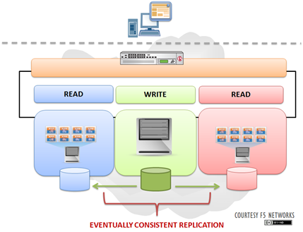

YOU CAN SCALE OUT READ but NOT WRITE
It is the unique characteristics of data that result in a quirky architecture that allows us to scale out read but only scale up write. This makes the database tier a lot more complex than perhaps it once was. In the past, a single ginormous server housed a database and it was the only path to data. Today, however, the need for better performance and support for hyperscaling of applications has led to a functional partitioning scheme that separates reads from writes and assumes that eventual consistency is better than non-availability.

Or you’ll need to consider the use of distributed database systems which can scale out by distributing data across multiple database nodes (local or remote) either using replication or duplication. When used over a LAN – low latency, high performing, high bandwidth – the replication and/or duplication required for the master database to manage and maintain its minion databases can be successful. One would assume, then, that the use of distributed database systems in a cloud computing environment would be the appropriate marriage of the two architectural approaches to scalability. However, most enterprise applications existing today – both developed in-house and packaged – do not take advantage of such technology and there exist no standardized means by which a traditional DBMS can be morphed into a DDBMS.
Additionally, the replication/duplication of database systems over a WAN – high latency, lower performing, low bandwidth – is problematic for maintaining consistency. Which often means a closed-system, LAN connected only approach to application architecture is the only feasible option.
