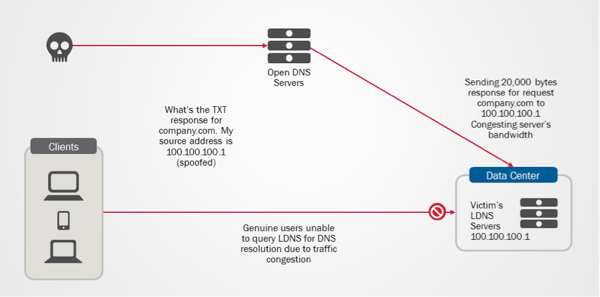

On DNS Amplification & DNS Reflection Attacks
You might concur that increasing DNS performance with adequate DNS rate limiting mechanism is probably one of the best approaches to tackle the problem of overwhelming DNS traffic and DNS DoS attacks. However, this does not address the issue of DNS Amplification and DNS reflection attacks, which has been made popular through the Spamhaus-Cyberbunker attack incident. In this incident, CyberBunker took the advantage of open DNS resolvers to launch DNS amplification attacks, causing Spamhaus to be unreachable at times. DNS amplification and reflection attacks are typically sent to DNS servers as legitimate DNS request, in hope to receive large data size responses. The huge data size responses will eventually use up all the available bandwidth causing congestion to genuine DNS queries and responses. As such, DNS query rate limiting mechanism and higher QPS performance will not be able to counter the attack since the attacks typically come in small numbers of DNS requests.
One of the ways to limit such attacks is to filter the request based on query type. Typically, DNS amplification and reflection attacks will request for ‘TXT’ or ‘ANY’ Query Type which tends to return responses with significant data size. By applying bandwidth rate limit to these query type request and large-data-size query responses, we will be able to prevent bandwidth congestion caused by these attacks. Worried about the complexity of the bandwidth rate limiting solution? Well, it only takes less than 10 lines of iRules (shown as below) on F5 DNS platform to get this enforced and implemented.

Diagram 1: DNS Reflection attacks blocking genuine users from accessing LDNS server.

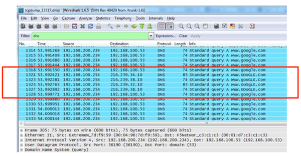

Based on DNS RFC standards, name servers are required to treat domain names request with case-insensitivity. In other words, the names www.foo.com and WWW.FOO.COM should resolve to the same IP address. However, most name servers will preserve the original case when echoing back the domain name in the response. Hence, by randomly varying the case of characters in domain names queried, we will be able to add entropy to requests. With this verification mechanism, the name server response must match the exact upper and lower case of every character in the name string; for instance, wWw.f5.CoM or WwW.f5.COm, which significantly reduces the success rate of cache poisoning attacks.
With F5’s DNS solution, this mechanism can be enabled with just a check box on the management pane. The packet capture of the query case randomization process by F5 DNS is shown as below. As depicted in the diagram, for queries to www.google.com, F5 Cache DNS will randomize the character case of the query prior sending the query to Google’s authoritative DNS server. This greatly reduces the chances of unsolicited queries matching the domain name and DNS request transaction ID, which causes the poisoning of cached DNS records. Diagram 2: Character case randomizer in F5 DNS solution dramatically reduces the possibilities of DNS cache poisoning attacks
