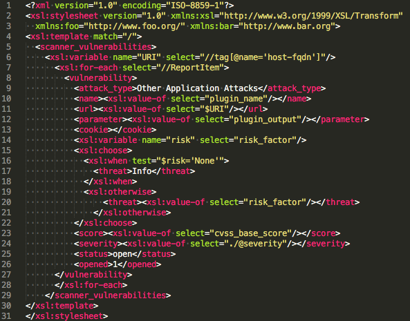

So how to tie it all together? There are some tools to help, online, I used to have on for Windows but I dont remember what its called, but I have a MAC now, so...
xsltproc ASM_Nessus.xsl Nessus_Scan.xml > ASM_Import.xml

Which gives me a pretty file to import to ASM. Its too big to post as text, but it looks like this:
Alright, so the final test, lets import to ASM...
Nice!
It could use some work around Attack Type mapping and Parameter mapping, but it looks like it works.

XSLT can be found on github: https://github.com/Mikej81/NessusGenericASMSchema
