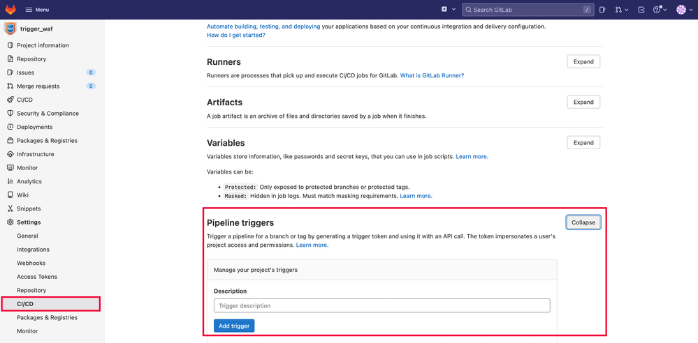

First, you’ll need to set up a pipeline trigger:
What this pipeline trigger allows you to do is execute pipeline jobs based on an API endpoint and token. Typically pipeline jobs would be executed on a change to the repository but in our case, we want to begin the pipeline from an external change.

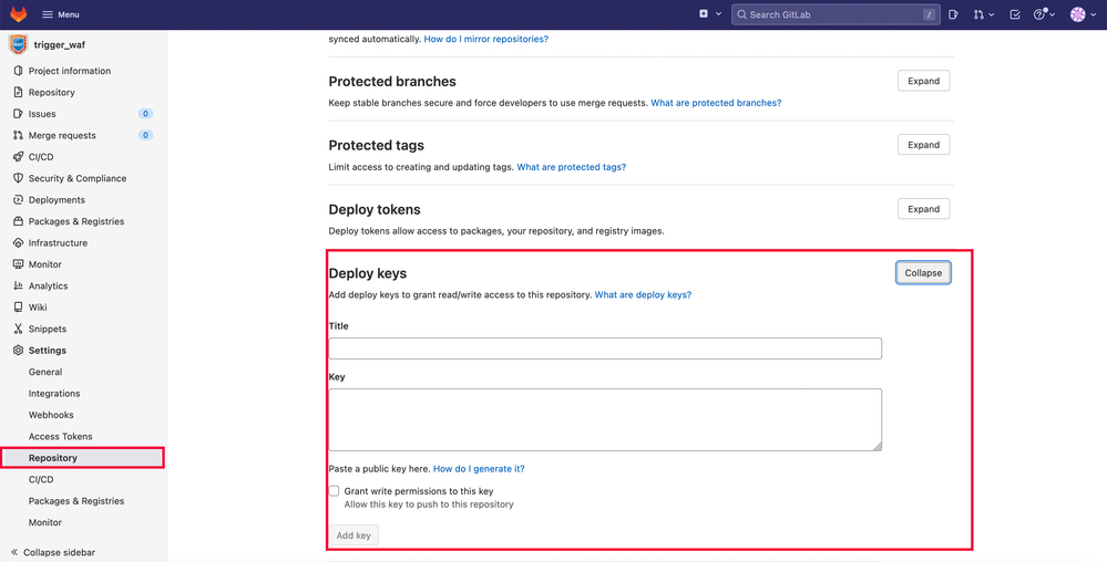

Next, you’ll need to create some ssh keys to create a deploy key. This key pair will be used by gitlab-runner (our container doing the pipeline jobs) to complete all of our GitOps on the WAF repository. In the Deploy Keys section you’ll add your ssh public key just like you would any system you’d like to access. Don’t forget to check “Grant write permissions to this key”.

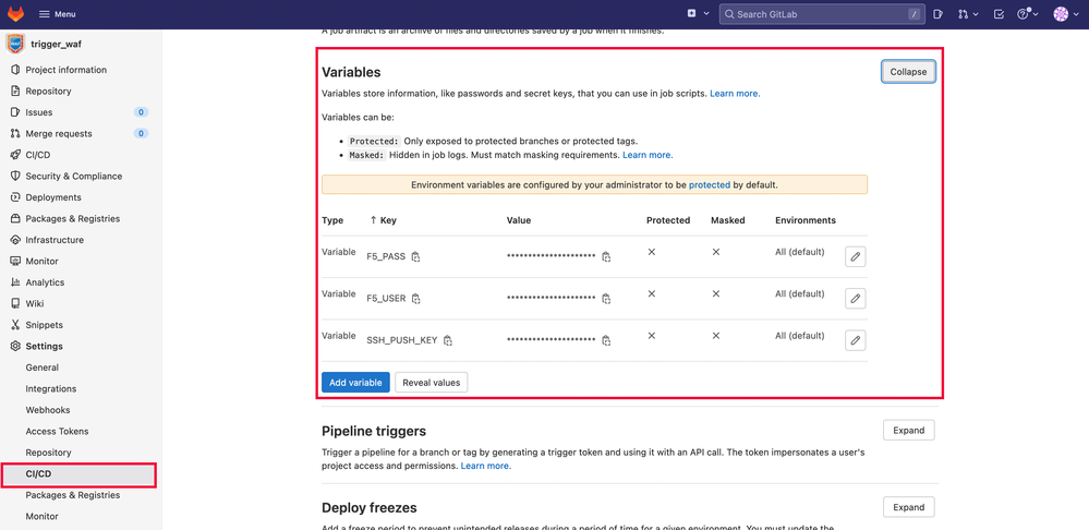

For the private key you’ll need to set up CI/CD Variables. As you can see from the example below, I have put mine into a variable called `SSH_PUSH_KEY`. Now the gitlab-runner will have access to push changes to the existing WAF policy file in the repository. The other two variables are referenced in my bash script to access the BIG-IP.

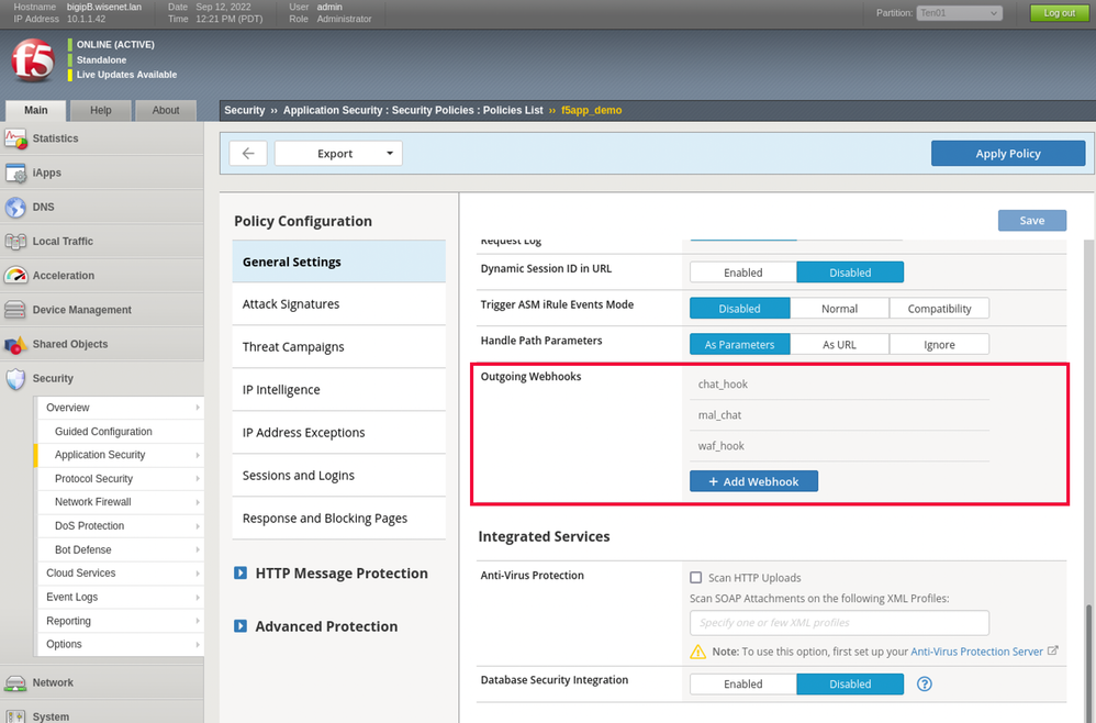

With BIG-IP Advanced WAF you also have the ability to utilize webhooks. In the example we are using 3 webhooks. One to fire the GitOps pipeline to keep the WAF policy in sync and two allowing us to enable ChatOps. When updates are made to the policy or malicious traffic is detected BIG-IP Advanced WAF can deliver messages to your team.

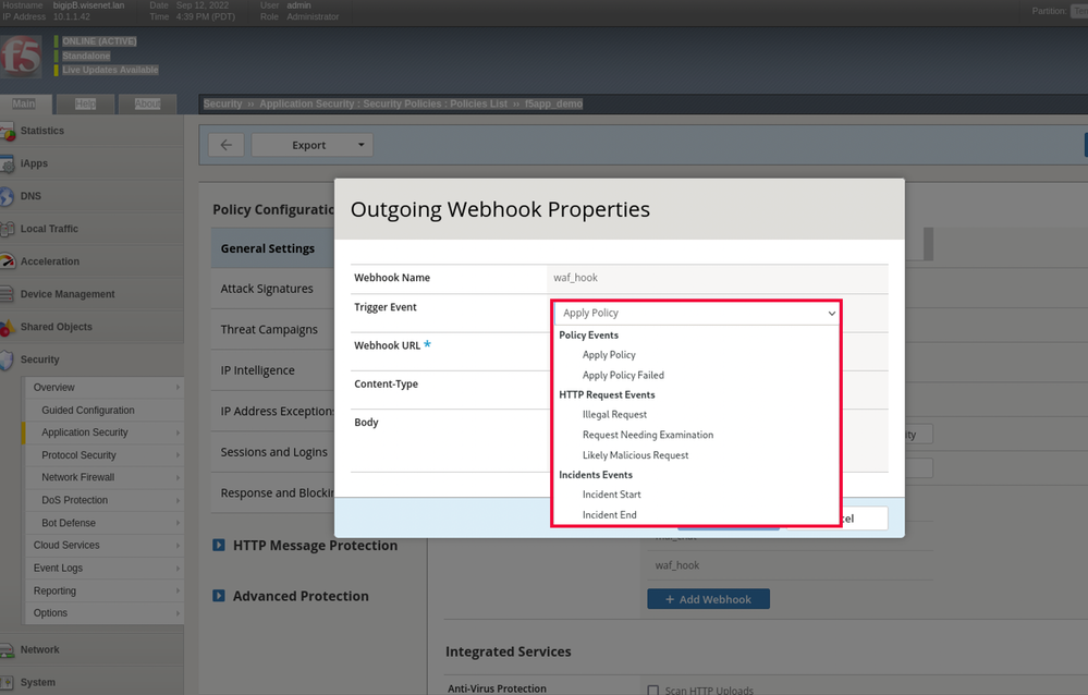

Here are optiions available when setting up trigger reasons from BIG-IP Advanced WAF:

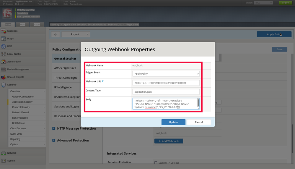

Here is the example webook configuration as configured from BIG-IP Advanced WAF user interface.
 Here is an example of our webhooks being defined in the Declarative WAF policy. There are some predefined variables (i.e. {{policy.name}} ) that can be used but equally as important we can send custom variables such as F5_IP. Allowing repository scripts to be as generic as possible.

              "body": "{\"token\": \"<insert token>\",\"ref\": \"main\",\"variables\": {\"POLICY_NAME\": \"{{policy.name}}\", \"HOST_NAME\": \"{{device.hostname}}\", \"F5_IP\": \"10.0.0.1\"}}",
              "contentType": "application/json",
              "name": "waf_hook",
              "triggerEvent": "apply-policy",
              "url": "http://gitlab.fqdn/api/v4/projects/1/trigger/pipeline"
