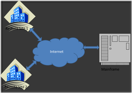

This company had, over time, become very distributed geographically, but still had some systems running on their mainframe back in corporate HQ. The systems needed to communicate back to the mainframe, but some of them were on horrible networks that would sometimes suffer latency and line quality issues, yet the requirement to run apps on the mainframe persisted. The mainframe has limited I/O capabilities without expensive upgrades that the organization would like to avoid, so they are considering alternate solutions to resolve the problem of one branch tying up resources with retransmits and long latency lags while the others back-filled the queue.
It’s more complex than that, but I’m keeping it simple for this blog, in hopes that if it applies to you directly, you’ll be better able to adapt the scenario to your situation. No highly distributed architecture with mainframe interconnects is simple, and they’re rarely exactly the same as another installation that fits the same description, but this will (hopefully) give you ideas.
This is the source problem – when site 1 (or site N) had connection problems, it locks up some of the mainframe’s I/O resources, slowing everything down. If multiple sites have problems with communications links, it could slow the entire “network” of sites communicating with the mainframe as things backed up and make even good connections come out slow.
