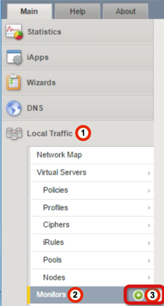

The next task is to create the Identity Manager Monitor for the BIG-IP Appliance to validate when the webserver is available. Use the following guidance to create a health monitor on the BIG-IP system.
  1. Click Local Traffic.
  2. Hover over Monitors.
  3. Click the Add button (+) to the right of Monitors to create a new health monitor.

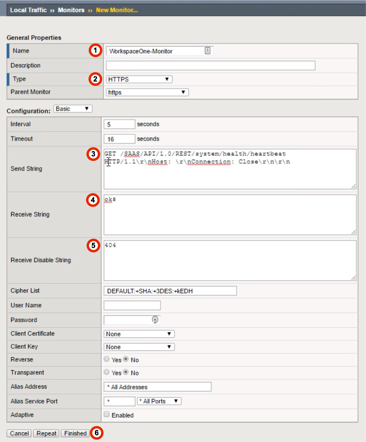

Monitor Configuration
Create a Monitor with the following settings.
  1. In the Name field, type a unique name such as WorkspaceOne-Monitor.
  2. From the Type list, select HTTPS.
  3. In the Send String field, type
    GET /SAAS/API/1.0/REST/system/health/heartbeat HTTP/1.1\r\nHost: \r\nConnection: Close\r\n\r\n
  4. In the Receive String field, type ok$.
  5. In the Receive Disable String field, type 404.
  6. Click Finished.
