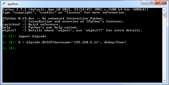

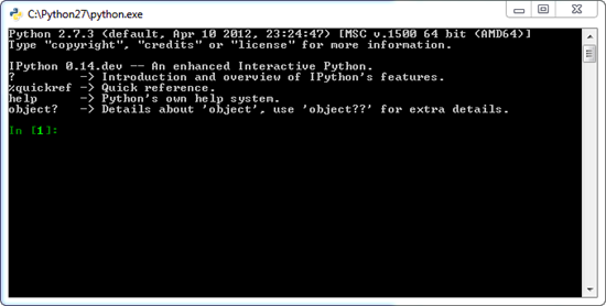

Now that the tools are installed, I can launch the ipython environment from cli or by clicking on the ipython.py icon in my file system.
Now, I can instantiate the BIG-IP, but instead of the default configuration, I'll add a debug mode as shown below

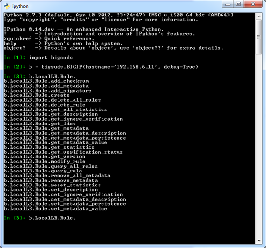

Next, I can enter an interface, such as LocalLB::Rule, and by hitting the tab key after b.LocalLB.Rule, I can get a listing of the methods instead of having to look them up in the API Reference on DevCentral.
Finally, I can select my method and by adding a question mark and hitting return, I can see the method documentation necessary for submitting arguments for the commands.
