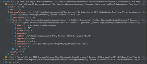

  • Hi   I fixed that last example, it should be sys.connection.load(), sorry about that!
  • Hi  , sorry for the delayed response, this one fell through the cracks. You can definitely get payload back for a combined selection and expansion, but not exactly as you desire. Because you are doing a selection on the top level object, you need to select name, tag, and then the entire interfacesReference. This is still beneficial to reduce how much useless data you pull back, but also still requires a little post-processing. In postman, the query looks like this:
    https://{{host}}/mgmt/tm/net/vlan?expandSubcollections=true&$select=name,tag,interfacesReference
    From the sdk, you need to format it as a single request params object:
    VLANS = b.tm.net.vlans.get_collection(requests_params={'params': {'expandSubcollections':'true', '$select': 'name,tag,interfacesReference'}})
    And the data returned looks like this:
    {'name': 'v.10', 'tag': 10, 'interfacesReference': {'link': 'https://localhost/mgmt/tm/net/vlan/~Common~v.10/interfaces?ver=15.1.0.5', 'isSubcollection': True, 'items': [{'kind': 'tm:net:vlan:interfaces:interfacesstate', 'name': '1.3', 'fullPath': '1.3', 'generation': 1, 'selfLink': 'https://localhost/mgmt/tm/net/vlan/~Common~v.10/interfaces/1.3?ver=15.1.0.5', 'tagMode': 'none', 'untagged': True, 'nameReference': {'link': 'https://localhost/mgmt/tm/net/interface/1.3?ver=15.1.0.5'}}]}}
    Or in picture format with pretty printing:
