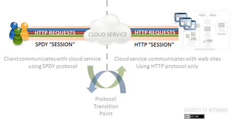

An advanced application delivery controller with network-side scripting ability could easily act as a translator for SPDY enabled clients interacting with non-SPDY enabled sites and applications. Through the use of network-side scripting, the HTTP data could be extracted, inserted into a traditional HTTP exchange with servers, and the responses re-injected into a SPDY-compliant data exchange with the client. Such an architecture could easily serve as a migratory step toward a fully SPDY-enabled web and application architecture, or as a means to support (the currently limited set of) SPDY-enabled browsers. Even in a SPDY-enabled architecture, an advanced application delivery controller remains a key component for security, access and capacity management. If able to extract and interpret SPDY, the intermediary retains its ability to perform processing on the data without sacrificing the inherent performance gains achieved by the nascent protocol. This allows existing web and application architectures to remain in place but supports the use of the protocol as a means of accelerating the end-user experience.
This approach is likely preferred by the infrastructure market itself as it remains to be seen whether SPDY will become more widely used in mobile devices (and other browsers) and the investment to natively support what is a new protocol in what is a rather large and varied market would need to be justified by widespread demand. If intermediaries are able to "speak" SPDY natively, they could act in much the same way IPv6 Gateways today serve as an transitional step between IPv4 and IPv6. In this respect, a component based on a full-proxy architecture is perfectly suited to inserting itself (and thus its other capabilities such as security and access control) into a SPDY conversation to ensure both sides of the equation are equally efficient and performant.
